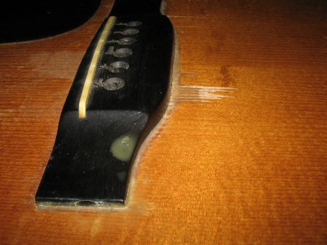

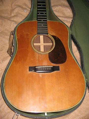

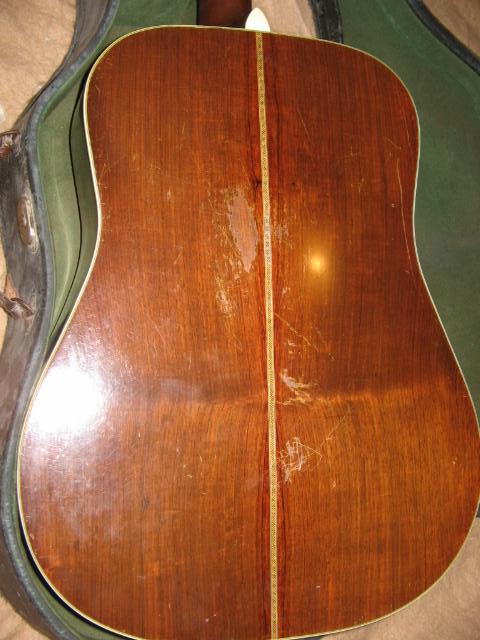

Here are a few pics. Rest assured that I'm not going to touch it and I will stress to it's owner the importance of having a qualified person do the appropriate repairs.

I'm no repairman, but from those pics, looks like the bridge has been removed and re-glued at some point, and who ever did it didn't clean up after him/herself.
Also, that's a low saddle with the string slots looking like they are cut right to the saddle. No doubt this guitar needs a neck reset and new saddle. Maybe a new bridge if those slots are cut back that far.
I'm sure the more experienced repairmen will have more to add or correct my stupidity.
